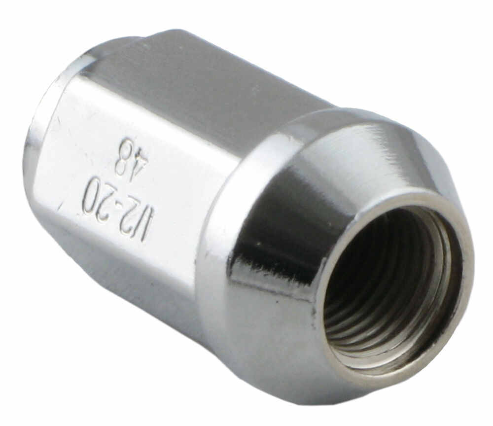

1/2"-20
Fits 1/2" wheel bolts
20 threads per inch
